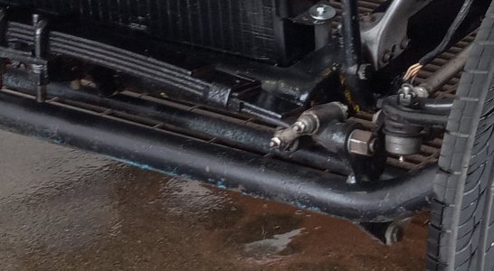

Since the current parts do not work together, you will probably need to replace them. I'd suggest longer steering arms so the tie rod is moved further back. But there is currently no steering box (if up front and cross steer) or drag link which would attach to the top left part in picture 1 or the same part on the floor in picture 3.

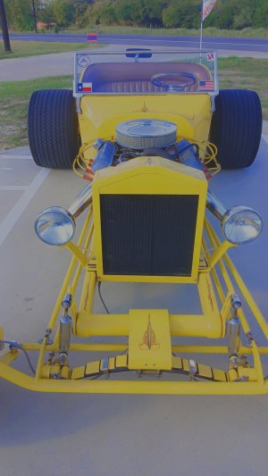

The picture in the Deathtrap thread shows a rear tie rod but at the top, not the bottom.
The upper left arm has both the tie rod arm and the drag link arm.
This can end up running into the radiator and headlight brackets, but the spring behind you have spaces everything forward so it may clear.
With a cross steer, this would require a low steering arm on the right and a tie rod arm on both top locations.

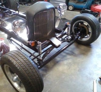

This one in the Sat In Texas thread shows a spring behind and a rear tie rod.
In this case, the spring perch is very long, but with careful planning, the tie rod could be under the frame.
